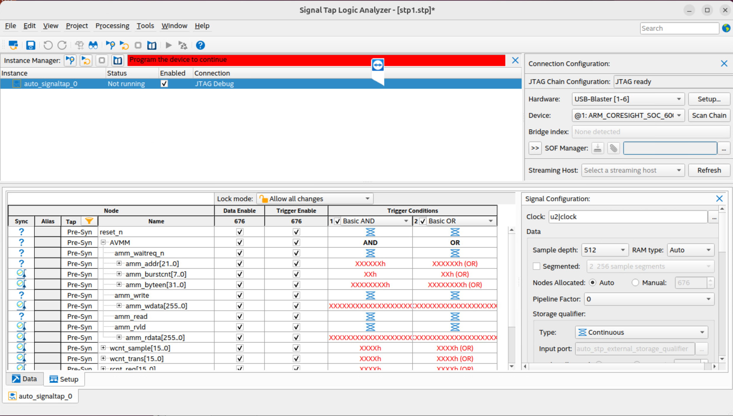

We are using mitysom-a5e-ref-base as a reference and we've added FPGA2SDRAM port to HPS and some Avalon Memeory-Mapped generator to initiate some traffic from FPGA to the SDRAM. We also addd Signal Tap to see if the generator is working.
We created SD Card image using a5e.core.rbf and programmed a5e.hps.jic and device was boot correctly. But then when we tried to connect with Signal Tap, we got the message: Program device. We checked the RBF from SD Card and it is correct.

As shown on the right side of your screenshot, you do not have the correct device selected. You need to select Device: @2 which is the FPGA. @1 device is the ARM.
Let me know if changing that drop box resolves your issue.
RE: Signal Tap not working - Added by Maxim Kanevsky about 2 months ago
Hello Mike, thanks a lot. Yes, not it is working
