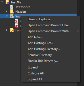

  • Open project in QtCreator
  • Right-click in the project area and click "Add existing files". Then select "gpiosingle.cpp" and "gpiosingle.h"
  • Build the project
