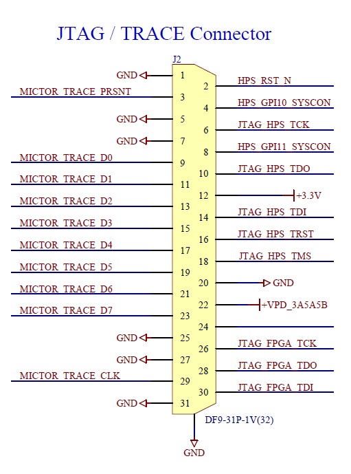

The MitySOM-5CSX features a 31-pin Hirose (DF9-31P-1V(32)) connector on the module, J2. This connector allows for both JTAG and TRACE connections through the use of breakout adapters that are available through Critical Link.
The pin-out for this connector, J2, on the module is as shown in the image below:

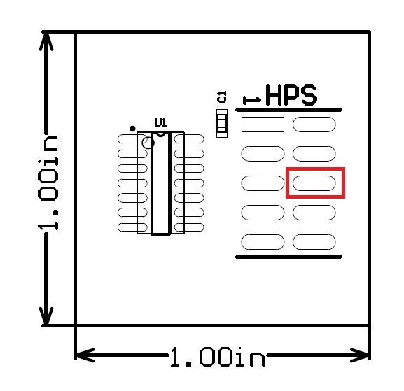

Reset problem with some USB JTAG Blaster adapters
There is a known issue when using some USB JTAG Blaster adapters and the JTAG only adapter for the MitySOM-5CSx. It is reported that when used together the module/processor may reset and prevent debug from occurring.
In this case we recommend that pin 6, shown below, of the "HPS" header either be removed or bent to a 90 degree angle so that it is not connected to the debug adapter.
