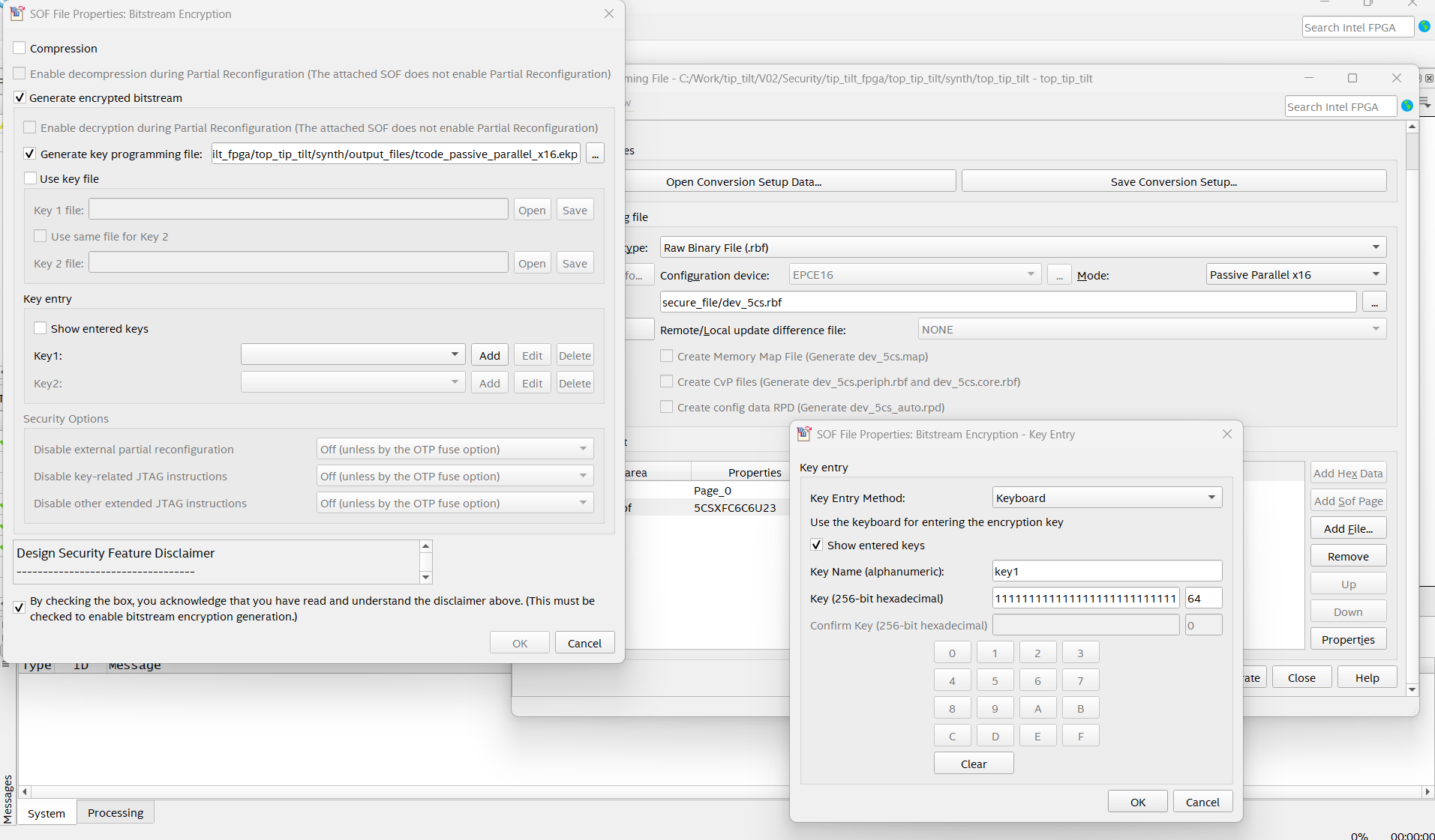

In Quartus, I enabled bitstream encryption and generated an encrypted RBF file (dev_5cs.rbf) as well as the corresponding .ekp key file (screenshots attached).

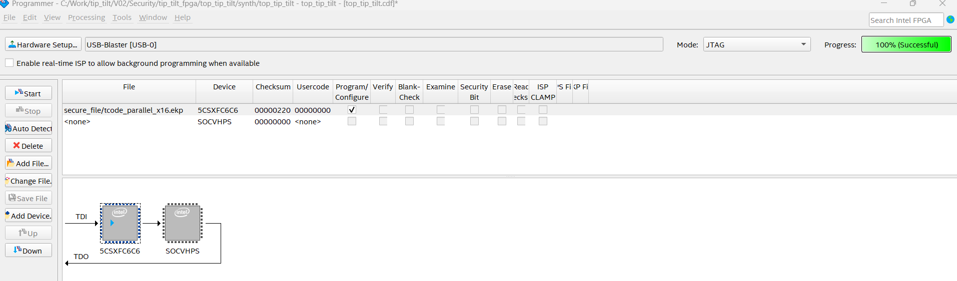

I programmed the .ekp file into the FPGA using Quartus Programmer (screenshot attached).

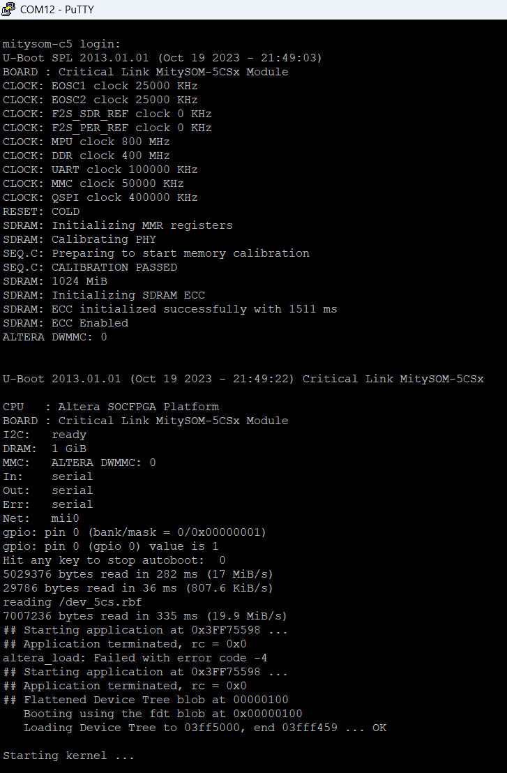

When I boot the system and monitor the console in PuTTY, the boot process stops at “Starting kernel …” and does not proceed further. If I replace the encrypted bitstream with an unencrypted .rbf file, the system boots correctly.

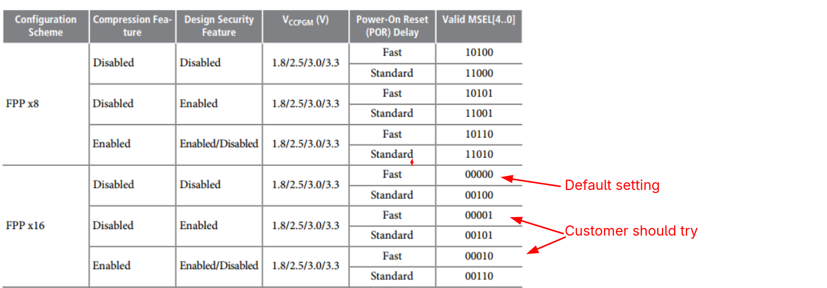

Atef,
Can you make sure you have the MSEL set appropriately per the table below?

Thanks, it works.
