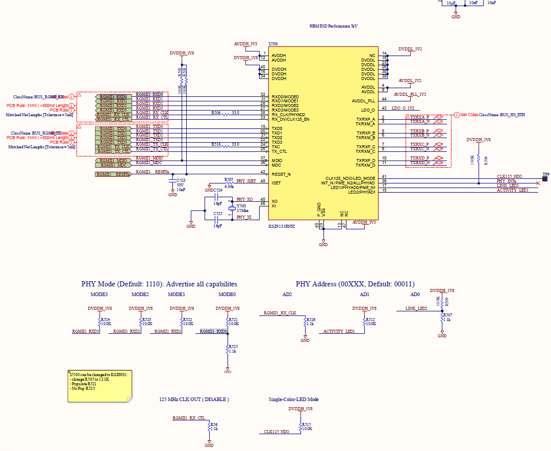

My custom carrier: same RGMII connections as the dev kit (clipboard-202512081603-uzgqp.png)
MODE0, MODE1 and MODE2 pins on the PHY are now strapped to match the dev kit schematic (same pull-up / pull-down configuration).

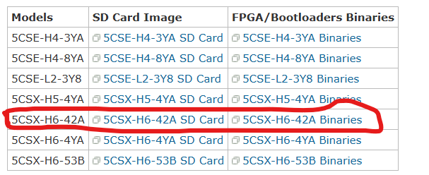

I downloaded an SD card image from your website/wiki (clipboard-202512081607-5qri5.png) and wrote it to a new SD card.

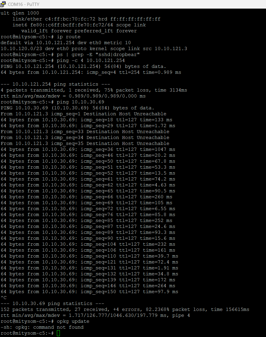

However, there is a lot of packet loss when I ping the board from my PC, and
I cannot connect via SSH: ssh always ends with “Connection timed out”. (
clipboard-202512081627-wp3pk.png)
On the console, there is no sshd or dropbear process running, and there is no opkg binary, so I cannot simply install a SSH server from packages (clipboard-202512081609-iswi2.png).
So, with the original dev-kit SD card SSH works fine on my custom carrier, but with the new SD image from the website SSH is not available and the network connection is unstable.

The image you downloaded should have an SSH server (OpenSSH) running by default, yes. ps by default doesn't show all processes, which is why the grep in your screenshot didn't find it. Running ps -A or ps aux should confirm that sshd is running.

Could you please let me know if the Ethernet hardware section of my carrier board (PHY and RGMII connections) looks correct (R525 is not connected) ?
Also, how can I verify that there are no RGMII skew/timing issues in my hardware design? Do you have any specific checks or measurement methods you recommend for this?

For layout, the two groups you have outlined in your schematic snippet should be matched in length and ideally be on the same layer. The clocks should be separated from the data lanes by at least 5x trace width. We usually use a 5mil matching rule for RGMII trace groups, with 50 Ohm impedance.
The PHY datasheet also has some routing rules regarding the ground plane between the PHY and the magnetics and Jack.
