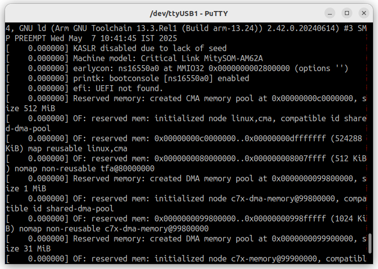

RE: Enable DDR ECC in Am62A processor - Added by Rajkumar Dumala 3 days ago
Hello Mike,
I reduced the CMA size to 512 MiB; however, the issue remains the same.I am providing the image for your reference.
Thank you,
Rajkumar.

[ 0.000000] OF: reserved mem: initialized node c7x-dma-memory@99800000, compatible id shared-dma-pool
[ 0.000000] OF: reserved mem: 0x0000000099800000..0x00000000998fffff (1024 KiB) nomap non-reusable c7x-dma-memory@99800000
[ 0.000000] Reserved memory: created DMA memory pool at 0x0000000099900000, size 31 MiB
[ 0.000000] OF: reserved mem: initialized node c7x-memory@99900000, compatible id shared-dma-pool
[ 0.000000] OF: reserved mem: 0x0000000099900000..0x000000009b7fffff (31744 KiB) nomap non-reusable c7x-memory@99900000
[ 0.000000] Reserved memory: created DMA memory pool at 0x000000009b800000, size 1 MiB
[ 0.000000] OF: reserved mem: initialized node r5f-dma-memory@9b800000, compatible id shared-dma-pool
[ 0.000000] OF: reserved mem: 0x000000009b800000..0x000000009b8fffff (1024 KiB) nomap non-reusable r5f-dma-memory@9b800000
[ 0.000000] Reserved memory: created DMA memory pool at 0x000000009b900000, size 15 MiB
[ 0.000000] OF: reserved mem: initialized node r5f-dma-memory@9b900000, compatible id shared-dma-pool
[ 0.000000] OF: reserved mem: 0x000000009b900000..0x000000009c7fffff (15360 KiB) nomap non-reusable r5f-dma-memory@9b900000
[ 0.000000] Reserved memory: created DMA memory pool at 0x000000009c800000, size 1 MiB
[ 0.000000] OF: reserved mem: initialized node r5f-dma-memory@9c800000, compatible id shared-dma-pool
[ 0.000000] OF: reserved mem: 0x000000009c800000..0x000000009c8fffff (1024 KiB) nomap non-reusable r5f-dma-memory@9c800000
[ 0.000000] Reserved memory: created DMA memory pool at 0x000000009c900000, size 30 MiB
[ 0.000000] OF: reserved mem: initialized node r5f-dma-memory@9c900000, compatible id shared-dma-pool
[ 0.000000] OF: reserved mem: 0x000000009c900000..0x000000009e6fffff (30720 KiB) nomap non-reusable r5f-dma-memory@9c900000
[ 0.000000] OF: reserved mem: 0x000000009e800000..0x000000009fffffff (24576 KiB) nomap non-reusable optee@9e800000
[ 0.000000] OF: reserved mem: 0x00000000a0000000..0x00000000a0ffffff (16384 KiB) nomap non-reusable edgeai-rtos-ipc-memory-region
[ 0.000000] Reserved memory: created DMA memory pool at 0x00000000a1000000, size 32 MiB
[ 0.000000] OF: reserved mem: initialized node edgeai-dma-memory@a1000000, compatible id shared-dma-pool
[ 0.000000] OF: reserved mem: 0x00000000a1000000..0x00000000a2ffffff (32768 KiB) nomap non-reusable edgeai-dma-memory@a1000000
[ 0.000000] OF: reserved mem: initialized node edgeai_shared-memories, compatible id dma-heap-carveout
[ 0.000000] OF: reserved mem: 0x00000000a3000000..0x00000000adffffff (180224 KiB) map non-reusable edgeai_shared-memories
[ 0.000000] Reserved memory: created DMA memory pool at 0x00000000ae000000, size 288 MiB
[ 0.000000] OF: reserved mem: initialized node edgeai-core-heap-memory@ae000000, compatible id shared-dma-pool
[ 0.000000] OF: reserved mem: 0x00000000ae000000..0x00000000bfffffff (294912 KiB) nomap non-reusable edgeai-core-heap-memory@ae000000
[ 0.000000] Internal error: synchronous external abort: 0000000096000010 [#1] PREEMPT SMP
[ 0.000000] Modules linked in:
Thank you,
Raj.
