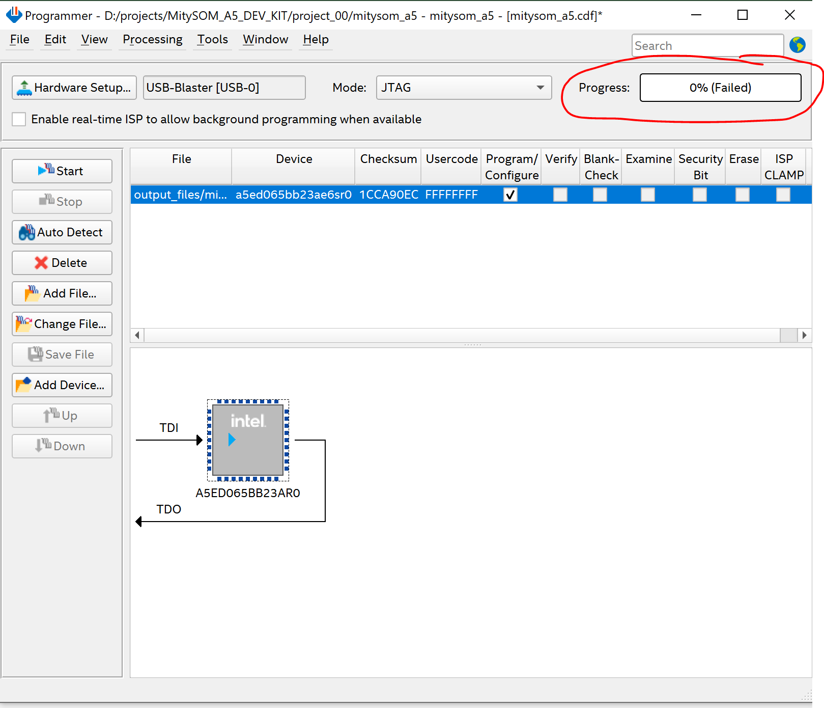

I've just got MitySOM_A5 Dev. Kit and started to work on it.
I'm trying to create my own project based on CriticalLink BASE Example Project (clone from GIT, PRO 24.2 Stable)
The idea is not to use HPS for this project, but FPGA fabric only.
When I compiled the project, trying to program it, it just fails and there is no error message:
Probably something wrong in QSF file
Attaching the archived project in Q24.2.0
Thanks!!!

RE: Fail to program device - Added by Mike Fiorenza about 2 months ago
Maxim,
Please use the instructions found here for programming the QSPI NOR Flash (from the command line): https://support.criticallink.com/redmine/projects/mitysom_a5/wiki/Building_fpga_242pro
I have not found a way to get the Programming GUI to work with the Agilex 5 part yet since this device uses an SDM and separates the devices into two separate targets (ARM vs FPGA). This is also how Altera documents programming the flash on their development kit.

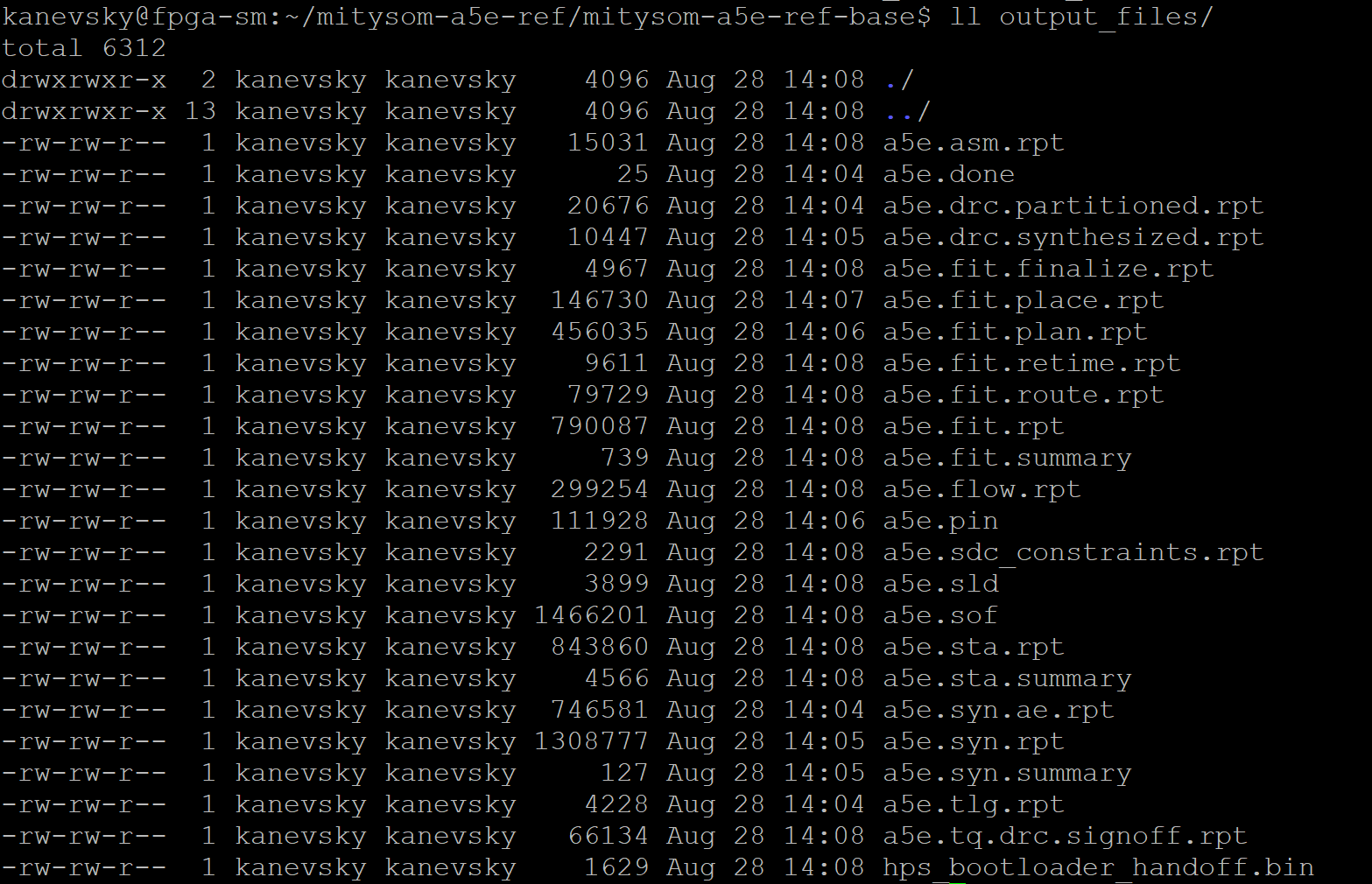

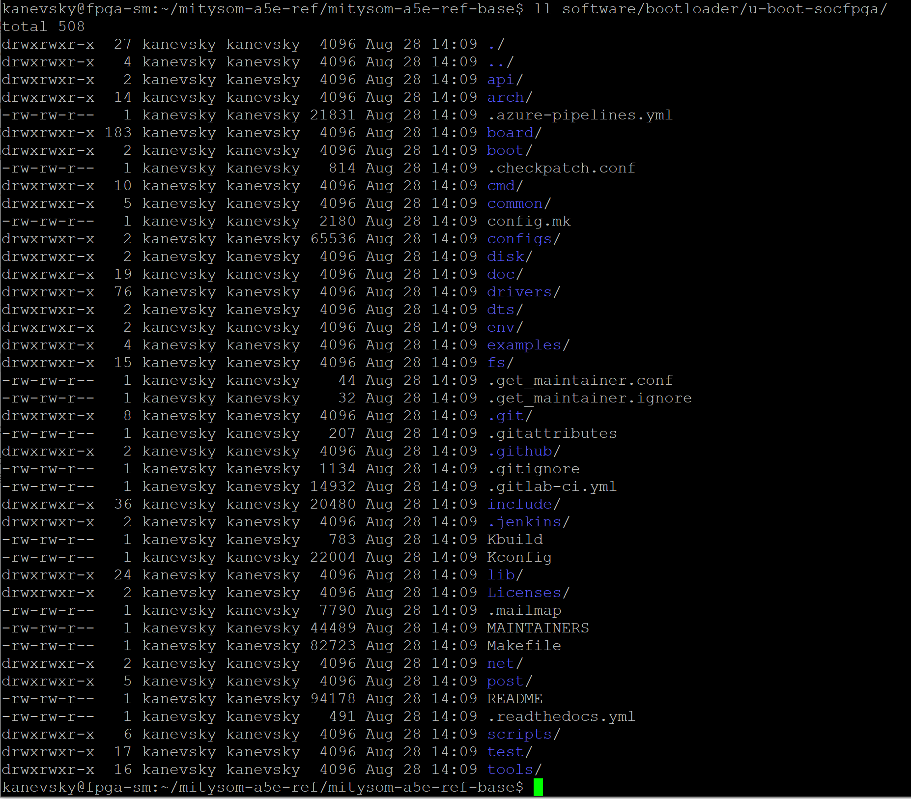

I've followed the instructions that you send me yesterday. The command "make jic" compiled the design.
I see directory software and under the path that specified in instructions, also in the folder output_files, no specified files:
output_files/a5e.hps.jic - The JIC file contains the preloader which is programming into the QSPI NOR.
output_files/a5e.core.rbf - The RBF file is the FPGA design, this belongs in /lib/firmware of the filesystem
software/bootloader/u-boot-socfpga/u-boot.itb - The bootloader file, this belongs in the FAT partition
But, the compilation passed successfully. What's wrong???
I followed the instructions as described. Run with Q24.2.0
Max
Did you make changes to the design to switch to FPGA first as described in my previous post? Or are you just trying to compile the reference design as is?
If you made changes to the design can you please list those changes and upload the files changed?
RE: Fail to program device - Added by Maxim Kanevsky about 2 months ago
Hello Mike,
No I didn't made any changes. I removed everything. I clone again, navigate to directory and run command "make jic". It run again and again no files as expected
Mike, please see attached log of the compilation
As shown by the log file it appears that you do not have the ARM toolchain installed. It is failing to compile the bootloader code. Please follow this wiki to install the GCC-ARM-11.2 toolchain.
