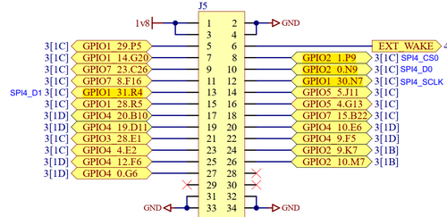

The SPI4 bus is accessible via the J5 expansion header:
Pin function ARM ball Devkit connector
SPI4_SCLK N7 J5-12 on devkit
SPI4_D1 R4 J5-13 on devkit
SPI4_D0 N9 J5-10 on devkit
SPI4_CS0 P9 J5-8 on devkit

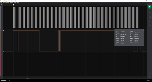

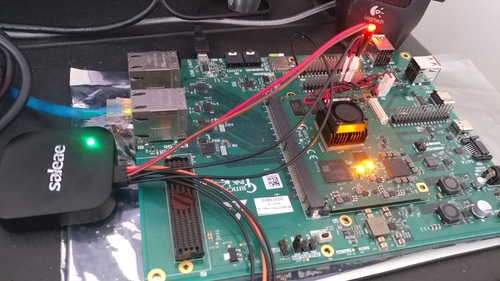

Connect logic analyzer or oscilloscope:
Run spidev_test
root@mitysom-am57x:~# ./spidev_test -D /dev/spidev1.0 -v
spi mode: 0x0
bits per word: 8
max speed: 500000 Hz (500 KHz)
TX | FF FF FF FF FF FF 40 00 00 00 00 95 FF FF FF FF FF FF FF FF FF FF FF FF FF FF FF FF FF FF F0 0D | ......@......................ð.
RX | 00 00 00 00 00 00 00 00 00 00 00 00 00 00 00 00 00 00 00 00 00 00 00 00 00 00 00 00 00 00 00 00 | ................................
Spi signals seen on spi4_sclk and spi4_d0
