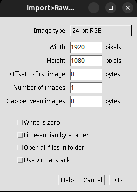

 - In the popup window change the settings to the following:
 - Select "OK"

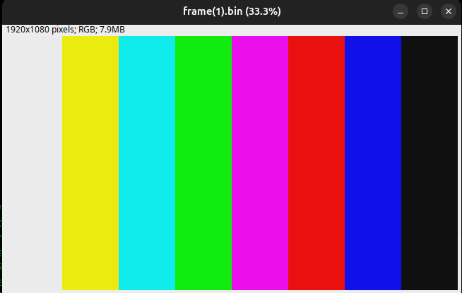

 - Navigate to toolbar->file->Import->Raw...
 - The raw image should look like the following:
