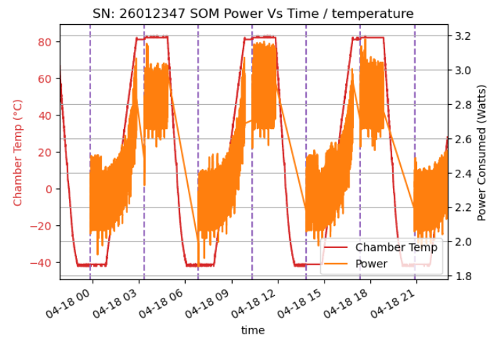

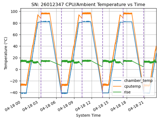

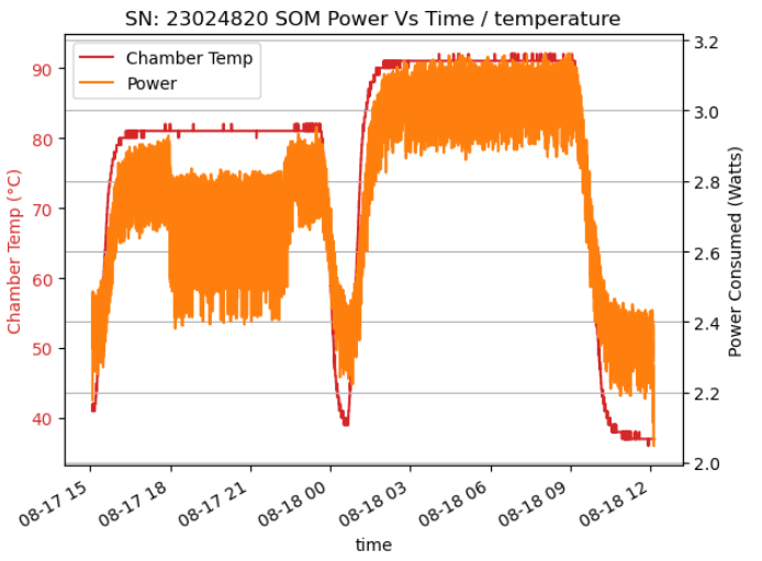

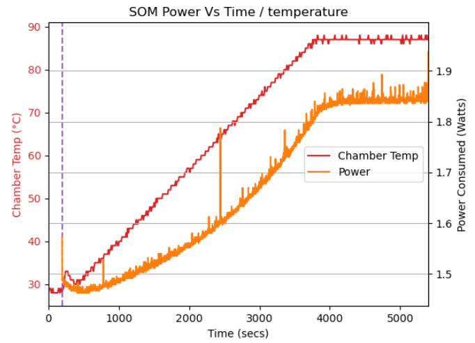

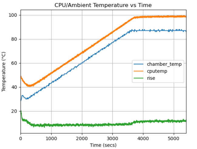

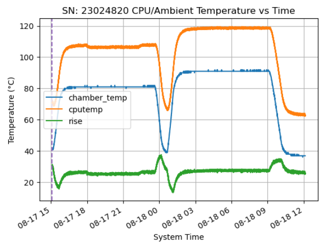

The system was allowed to run while the environmental chamber ranged from -45C to +85C, including soaks at each end of the range.
The figures below show the temperature of the AM62Px (die temperature as reported by the kernel software), the chamber, the computed temperature rise, and the power consumed by the SOM.
