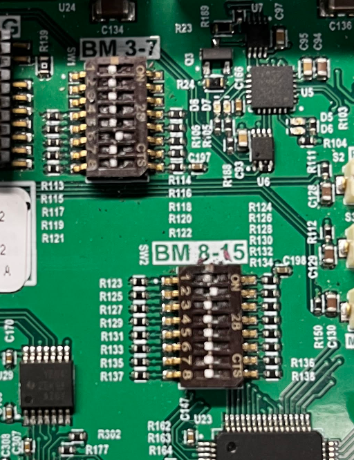

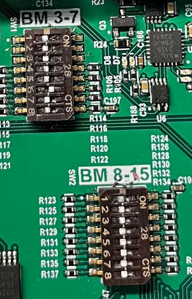

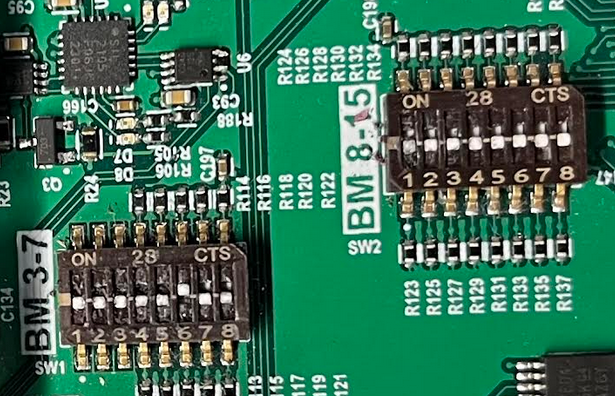

Boot Pin and Hardware Configuration
Boot Pin Layout
B3 B4 B5 B6 B7 B8 B9
0 0 1 0 Link Info (0) 0 Clkout Off (0)
Hardware Setup
  • Using the USB eth adapter and ethernet cable, connect the devkit ethernet port J4 to the host computer
