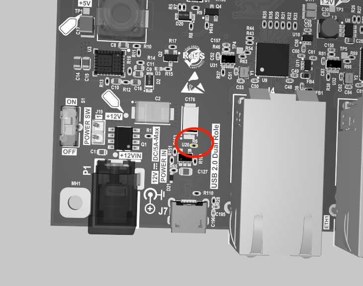

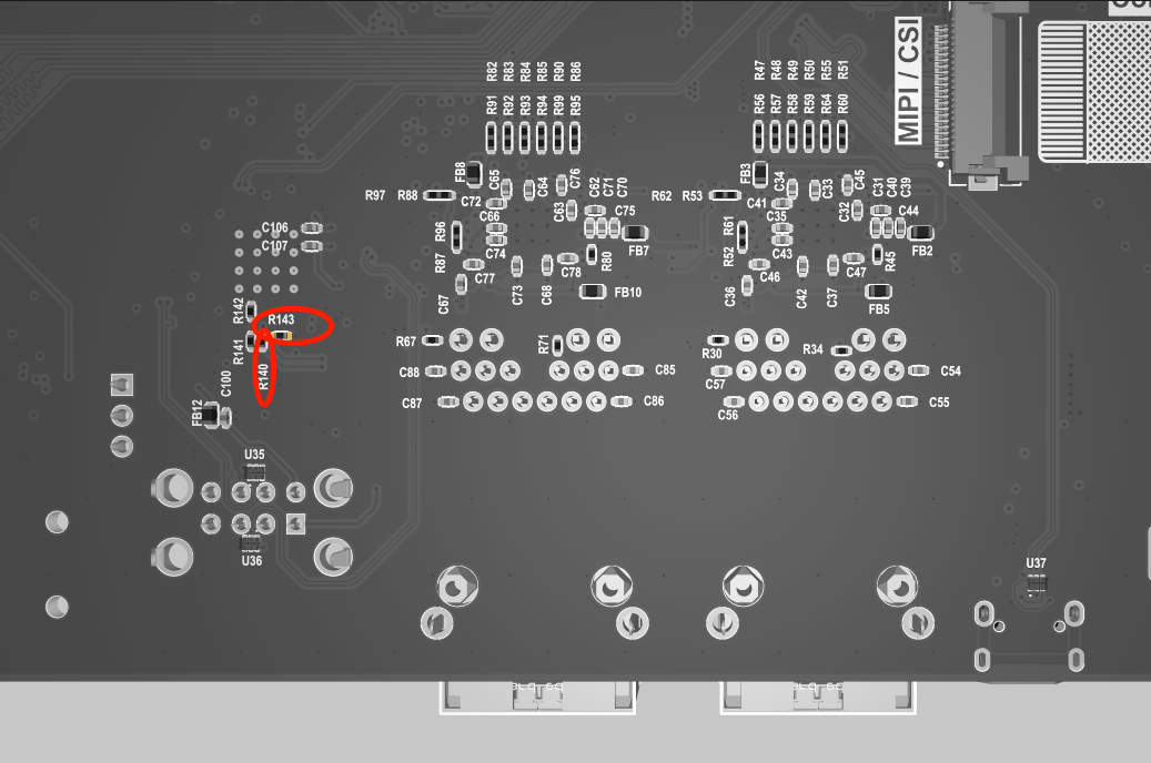

USB HUB wakeup source on DevKit
In addition, for the current release of the DevKit, the USB port that is connected to the HUB (USB1) must be disabled in order to enter and remain in sleep mode. Currently there are pullup/pulldown resistors on the DevKit on the USB hub interface that must be removed in order to clear this issue (R6, R140, and R143). A note and errata for this issue will be published when final details are available. Please contact critical link for more details.
